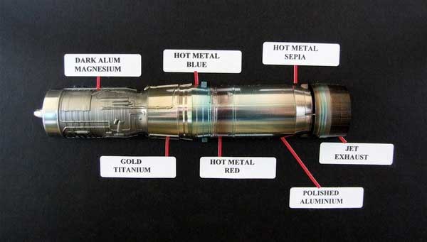

There is one metallic paint "Alclad II 金屬塗料" which is a very good metallic paint and can produce true metallic shine surface finish.
The "Dark Alum Magnesium" paint can produce a color similar to the color of no.28 plastic cap.
However, this paint is difficult to get, expensive, require long period of time to get completely dry and will fake off metal powder when you touch it.
I don't think it is worth to try it.

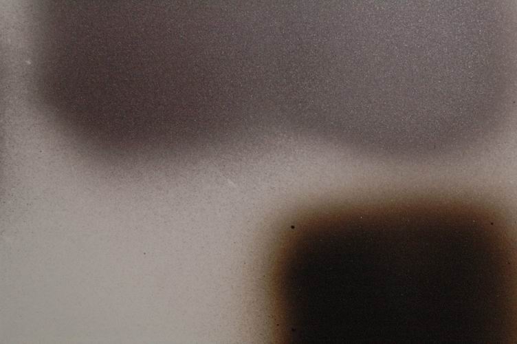

Quickly try the effect of other dark metallic color from Mr. Hobby.
Top left: 50% no.61 "Burnt Iron" + 50% no. 101 "Smoke Gray"
Top right: 100% no.61 "Burnt Iron"
Bottom right: 100% no.28 "Steel"
Top left seems to be more close to the color as shown on the plastic cap of no.28 "Steel".
You may also vary the content of "Smoke Gray" to get lighter or darker appearance.
Hope the above is helpful for you.

kelvintsang1133
UID 7567
帖子 420
註冊 2006-1-20
發表於 2008-11-21 08:53 AM  資料  短消息  加為好友
回復 #12 Safeterence 的帖子
oh...really thanks for u...the top left one is the one i like....
