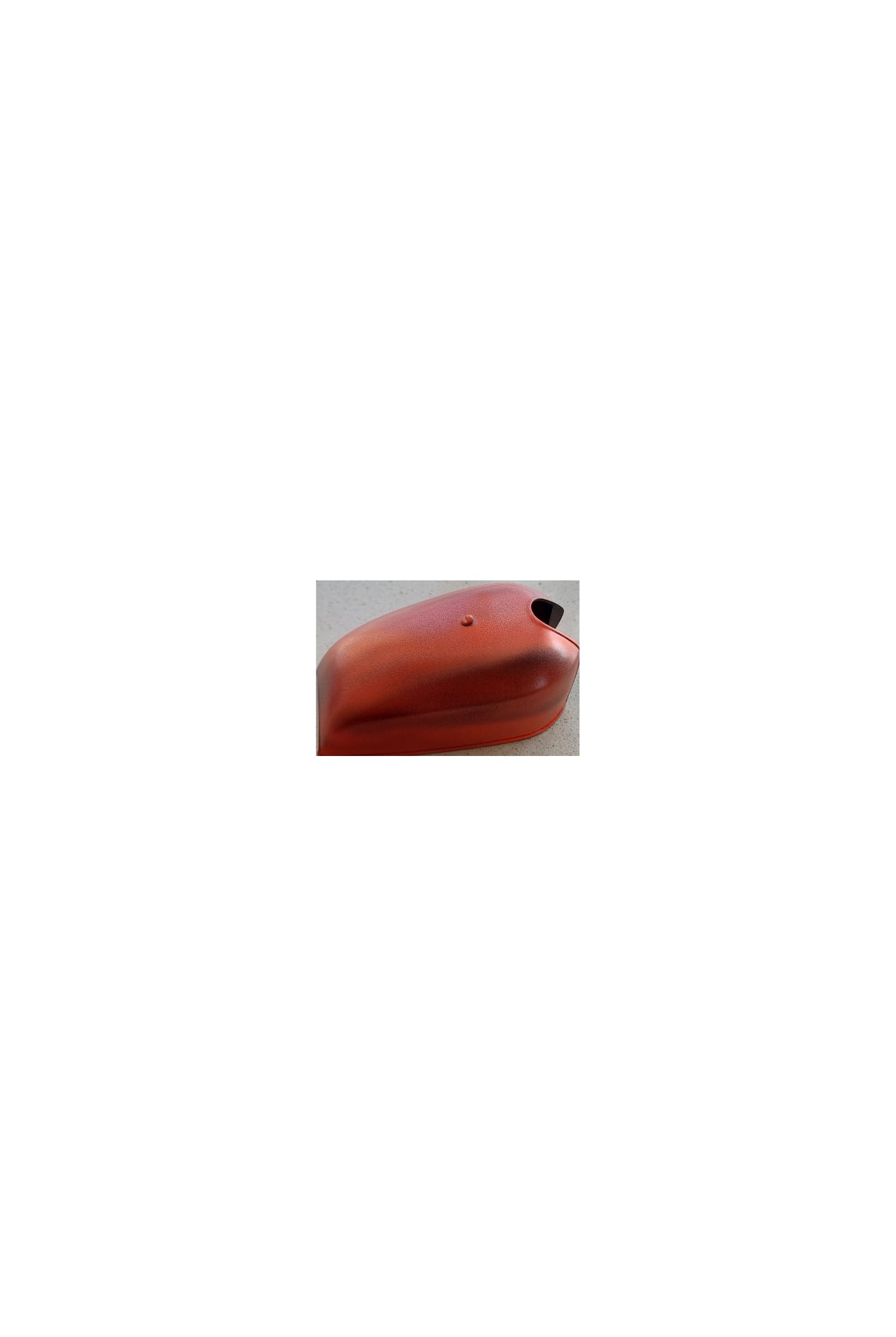

噴塗問題
請問各大師:
我用黑底油,再用光黑油,件的表面很光滑,但我用上銀色和透明紅就出現不平滑,我亦在較乾燥的環境下噴塗。請問出現甚麼問題

spray too close & overed.
you respray the same surface before dry?

I usually spray when the humidity is below 80%.

for this case, not the humidity issue.
i think you spray too close & high air pressure make thinner volatiles faster than normal.
hence created 起沙/橙皮 result.
try to adjust the paint : thinner proportion, can't always mix at 1:2, need sightly adjust based on pigments, etc.
