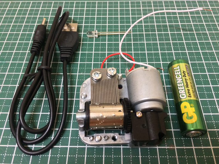

­ø¸ÓËݦh¦ì®v¥S¡A§Ú¦³¤@­Ó¹q°Ê­µ¼Ö²°¹s¥ó(¼¯¥´)¡A¥i¥H¥Î¤@²É2A¹q±À°Ê
¦pªG§Ú·Q¥[¦h¤@²ÉLED¦A»éUSB­Ú¹q¦³µL°ÝÃD¡H
»Ý­ø»Ý­n¥[¹qªý¡H­ø¥[·|­ø·|¿N¡H
Thanks so much

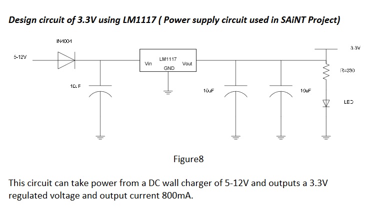

¥Õled 3.4v ¨Ó... ¤@²ÉAA¥u¦³1.2/1.5v. ­øµÛªº.
ok.. ¨Ì®a¦³¤@­Ó¼¯¥´, ·í¦æ1.5v°Õ. ¤@²É¥Õled, ¦æ3.4v... §Y«Y³Ì¤Ö¬Jvoltage ³£­n¦³3.4...
§Y«Y³Ì¤Ö­n3²ÉAA >> 3.6~4.5v ËݦP³Ì¶}©l¦Pusb ³£®t­ø¦h¤F.
¦]¬°input °ª¹L­Ó¼¯¥´Ëݦh...  ¦pªG§Ú´N·|¥Î²É1.5V fix output ¬J voltage regulator (¦pLM1117-1.5, ·íµM¦³¨ä¥L, Á|¨Ò¦Ó¤w).
©OÃþvoltage regulator ³£¦³3°¦¸}, ¤S­n¦A¥[¨â²É cap, ÂI³£¥s«Y²³æ¹q¸ô...
¦Ó¦]¬°«Yfix output, ©Ò¥H¥i¥H§ï¦æ usb ³£±o, ¤£¹L´N­nÚ»¤U²É¥Õled ³»­ø³»¨ì5v. ­ø±o¤S¥i¥H¾ã¦h²É LM1117-3.3
©O­Ó¥u«Y§Ú·|¾ã¬J¤èªk, ¥i¯à¦³¨ä¥L§ó²³æª½±µ¬J... ËÝ´N­n¨ä¥L¤H«ü¥X¤F.

¥¿½Td Á¿«Y LDO (Low DropOut) regulator "§CÀ£®t½u©ÊíÀ£¾¹".. §AÁ¿ LDO À³¸Ó©ú«Y«§
Cap -- Capacitor ¹q®e... ¥scap ±o¬[°Õ.
§AÁ¿®I«Y LM1117 ªGÃþ.. ¥X´X¦hvolt (1.5v /1.8v/ 3.3v,  5v etc)¬J. ³£·|©ú«Y«§.. lm1117 ºâ«Ycommon ³¥¨Ó.

­ø¦n·N«ä°­¥S¦A°Ý¦h¤Ö¤Ö¡A§Ú¶R¤@²É5V LDO(LM1117)¥X1.5V¡A¥¿½T¶Ü¡H
ËÝcap¦³µL¤À¡HÀ³¸Ó¶RÃäºØcap¡H

¦³. ·íµM¦³°Õ. ¦³¤À´X¦hf ¦P´X¦h v, ¥ò¦³¤Àdc©wac¥Î.
Cap ¬J, 10uf 6VDC. ­n¨â²É. ¯d·Ndc¥Î cap ¦P led ¤@¼Ë, ¦³¤À+/-·¥. ¥ç¦Pled ¤@¼Ë, ªø¸}ªG±ø«Y+·¥.. ¦P¼Ëªø´N­nÚ»¤W­±¬Jmarking.
LM1117-1.5 «YÉN¤À´X¦hvolt in, ¥u¦³¤À´X¦hvolt out.

·Ó§Ú¨Ì®a嘅°ÝÃD¡A·Q¥ÎUSB­Ú¹q¼¯¥´¦P¤@²ÉLED(¥Õ¥ú)
ËݧÚÀ³¸Ó¥ÎÃäºØcap¡H

«}Á¿¥ª 10uf 6V DC
´NËÝ10uf 6V ³£©ú¬[°Õ.

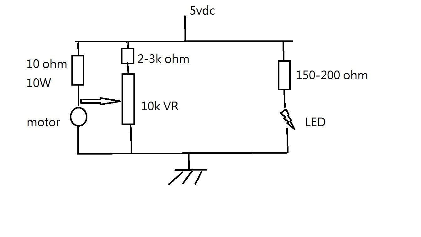

¨ä¹ê´X²É¹qªý¤w¸g¹F¨ì°ÝÃD»Ý¨D,¦Ó¥B­µ¼Ö²°¥i¥H½Õ­µªº.

¦hÁÂgoodfriend¥S±Ð¾É¡A¨ä¹ê§Ú¥u«Y·Q¥Î³Ì²³æ嘅¤èªk¥h­Ú¹q­µ¼Ö²°¦PLED
§ÚµLŪ¹L¹q¡A¹q©O¤è­±¥u«YÃÑ¥¿­t·¥¡A³s¤§«e°­¥SÁ¿嘅LDO¡BCAP«Y«§³£­øÃÑ
¦pªG§A¦³«§Â²³æ¤èªk¥i¥H±Ð¾É¤U¤p§Ì¡A¸U¤À·P¿E
