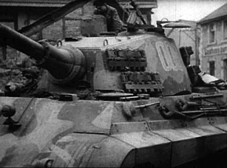

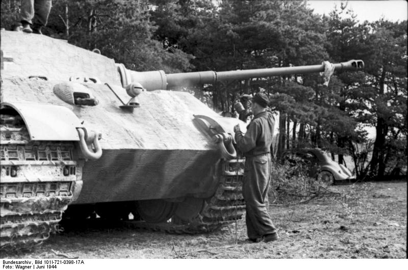

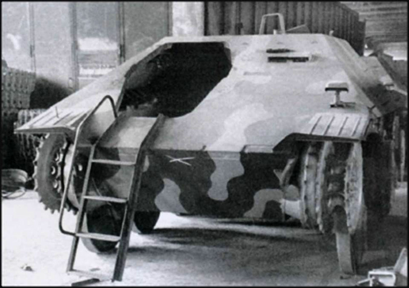

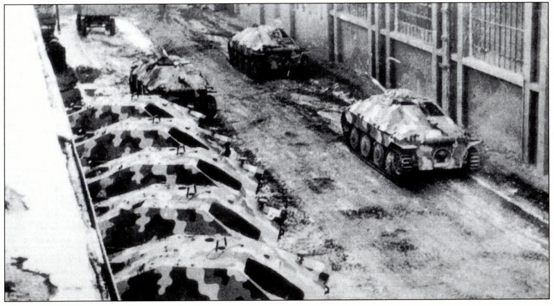

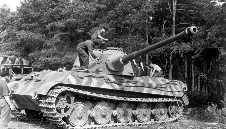

三色迷彩 有"軟"有"硬"..

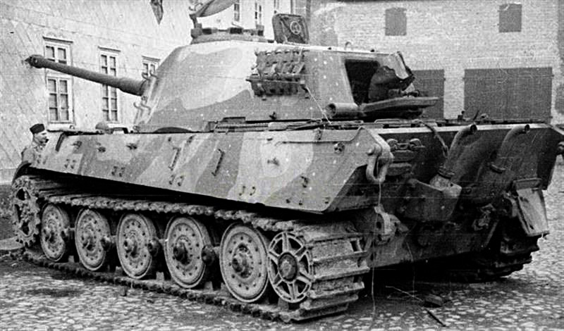

"....有"軟"有"硬"...." 之餘, 在"軟"中的柔邊亦有分: 好化與唔係幾化
視乎 "噴油師傅" (唔知乜嘢兵種 ) 的手勢啦, 心情啦, 趕唔趕時間啦.....更可能是嗰位根本唔係"噴油師傅", 而係臨時拉夫的生手技工
也有環境因素 : 在唔係幾化的柔邊上舖滿沙塵, 睇落條邊界便朦朧左囉

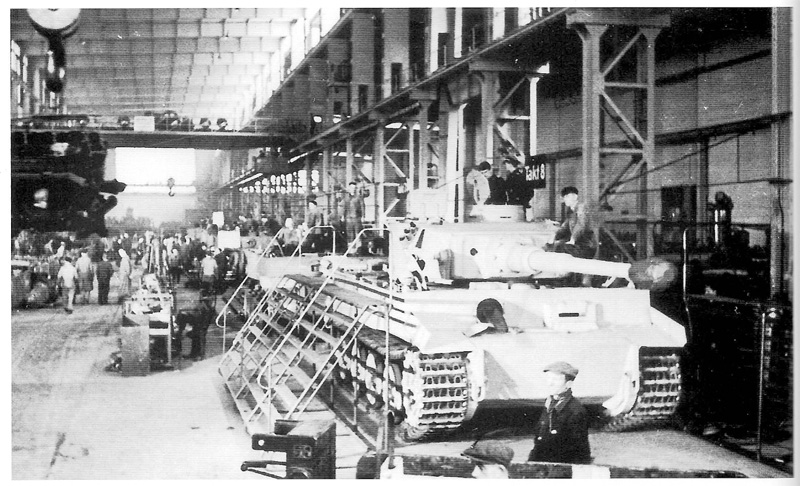

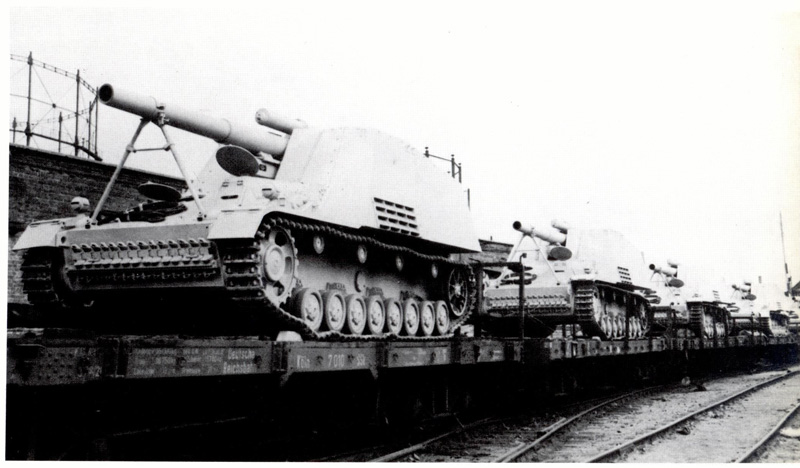

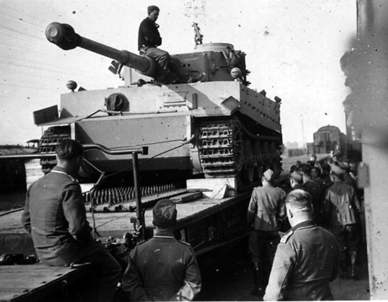

正常情況下會用列車運送。

原帖由 松尾明 於 2015-5-21 04:14 PM 發表
順道一問, 坊間有種說法, 是出廠至戰地是防锈紅塗裝, 再在前線塗上土黃及綠色色塊而成三色迷彩, 不知是否這樣?

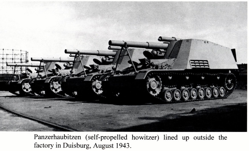

出廠時係沙黃色,迷彩色係交到前線後由士兵自己負責油上的,所以無特定標準。
情況同 SS兵 件迷彩外衣(smocks)差唔多,SS 部隊迷彩外衣都係自己搵製衣廠定造,所以各個部隊顏色圖案都有出入。

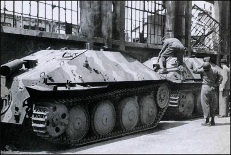

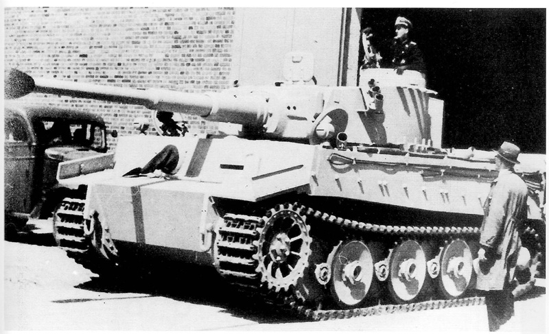

二戰納粹德軍戰車塗裝正式指引如下 :-
http://www.missing-lynx.com/panzer_facts.htm    <------ 全文
摘要 :-
Start of the War
  - two-tone scheme of Dunklegrau (dark grey RAL 7021) base coat, and Dunklebraun (dark brown RAL 7017).
June 1940
  - only use Dunklegrau (dark grey RAL 7021) for the entire surface.
February 1943
  - Dunklegelb nach Muster (dark yellow RAL 7028) as base coat
  - Field units were issued Rotbraun (red brown RAL 8017) and Olivgruen (dark olive green RAL 6003) paste concentrate to create camouflage patterns suitable for local conditions.
August 1944
  - Dunklegelb (dark yellow RAL 7028) as the base coat with Olivgruen (dark olive green RAL 6003) & Rotbraun (red brown RAL 8017) camouflages applied at the assembly plant.
   (This has become known as the “ambush” camouflage scheme)
September 1944 (**松兄所提的)
  - Panzers left the assembly plants with a base coat of primer Rot (dark red RLM 8012)
with only about half of the surface covered with patches of Rotbraun, Olivgruen, or Dunklegelb.
November 1944  (*** but not to go into full effect until June 1945)
  - base coat of Dunkelgruen (dark green RAL 6003)
  - camouflage pattern was to be created at the assembly plant by spraying on Rotbraun or Dunklegelb in sharp contours.

發表於 2015-5-22 03:40 PM  資料  短消息  加為好友  添加 wingzz 為MSN好友 通過MSN和 wingzz 交談
