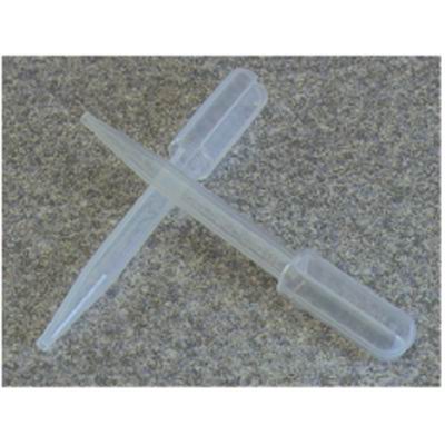

再唔係用dropper,不過會有D油殘留,同一隻色一支dropper,都幾係野
