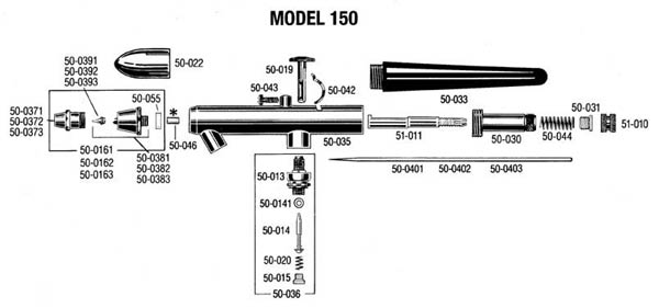

近排我係網上bid左技badger 150
但係佢剩係得 medium 同 large  既 head, tip, needle, regulator
我想問呢, 唔同size 既 head,tip,needle,regulator 可唔可以互相通用?
如果可以, 效果又會係點呢? (比如話medium head and tip, large regulator, fine needle)
圖入面最左面數過去第一個係 Regulator, 第二個係tip, 第三個係head
唔該哂!!

HEAD 同針係須要配合返既... (我自己有用badger150多年, 係用左多年150, 唔係我用左一百五十多年, 我叫vampire姐, 唔係真係vampire )

買既通常成組 "head"咁配, 唔會單part 配...

咁即係 regulator 可以共用??
同埋其實用黎噴 gundam, 剩係用 medium 同 large 夠唔夠?
聽講fine 係 0.2, medium 係0.3, large 係 0.4?
thanks =]

哈哈...我買完支筆之後見到有一set large 既 head + tip (冇regulator) $3 USD, 順手又買埋...不過睇黎好似都冇乜用

唔得.. 唔係共用的. 個hole唔同size的..
全組head 唯一共用係個o-ring 50-055
