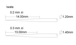

Iwata ¼Qµ§°w§`¦T
¤µ¤é«Yrms ¦P´X¦ì¼Ò¤ÍÁ¿¶}¼Qµ§, ¦³®v¥S·Qª¾¹D iwata ¬J°w¬J§`¦T.
ÀY¥ý§Ú¥Î¥d¦T«×¥ª. ¥i¥H°Ñ¦Ò¤@¤U.

¯u«Y¦n¥J²Ó!
°wªº "¦¬¤f" ªø«×¦nÃø¤¶©w, ¦]¬°¦nÃø¨M©w¨º¤@ÂI¶}©l¥H¦P¤@¯S©w¨¤«×¶É±×
¤Ï¦Ó linear air flow angle of needle ´N®e©ö±o¥X·Ç½T«×, ­øª¾¦³ÉN¦¹­«­n¼Æ¾Ú©O?
Badger ªº¼Qµ§Â²³æÁ¿¸Ñ101¦³Á¿¹L吓 :-
"........Ultimately the fineness of line is
determined by a combination of factors ¡V nozzle size, linear air flow angle of the needle, pigment/base ratio, and pigment size.
You must to have the right nozzle with the right spray medium to achieve optimum airbrush performance."""
http://www.badgerairbrush.com/PDF/airbrush101bdgrtconly.pdf
¨Ò¦p¥¦ªº Renegade Series ªº ultra fine nozzle ¤f®| 0.21mm ¬O 6«×
                                                  ¦Ó   fine nozzle ¤f®| 0.33mm ¬O6.5«×
¥b«×ªº®t§O¦b¼Qµ§¨Ó»¡¤w¬O«Ü©úÅ㪺¤£¦P¼Q¶î®ÄªG.

©C¬J¨¤«×­ì¨Ó¦³Ëݤj¼vÅT, ¤S¾Ç¨ì³¥¤F ©C¦P°w¯u«Y¦¨ªKµ§¬JÆF»î
¤£¹L§Ú§ä­ø¨ìiwata ªG D ¬J¨¤«×

ü«µf¤½¥q¥Î profile projector «×

Gunze 267 ~~ 0.2mm
ªo°w
Dia = 1.4mm, slant ~ 14mm
¤ä 0.2mm 270 «á¸É ~~
¼Æ¦r¤W, iwata ¤ä 0.3ªo°w¥i¥H¥Î¸¨ GSI 0.2 ¾ð ~~~

¨ä¹ê, §Ú¦açܺò¬JµM gunze «Y iwata ³yªº¸Ü, ËÝ, ¶R iwata spare parts ¸¨ gunze 嘅¥i¯à©Ê
«Y§r, iwata d part©ö§ä¹L gunze ¬J¦n¦h³Â.

«á³Æ¹s¥ó back up ¦n­«­n!  ¦n¦ü¼Ò«¬ªo, ©úª¾ Humbrol ªo«Yè°®æ, ¦ýÂI´±¶R§r!!
