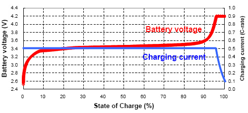

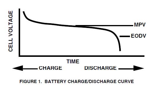

可能你唔知啦... rechargeable 電池所寫既volt 數係 mpv (mid point voltage), 意思係, 當真正charge 滿電時, 個volt數係大過包裝面上既, 而volt 數係會隨住電量流失而減少.
亦因為呢個特性, d battery tester 測電量時, 實際係測緊voltage數.
亦所以, 要charge 滿電池, 係一定要用高過電池上所寫既voltage去charge舊電先做得到. ..
http://www.ti.com/lit/an/snva533/snva533.pdf
The Charge/Discharge Curve
The measured terminal voltage of any battery will vary as it is charged and discharged
(see Figure 1).The  MPV  (mid-point voltage) is the nominal voltage of the cell during charge or dis-charge.
The maximum and minimum voltage excursion from the nominal value is an important design consideration:
a "flatter" discharge curve means less voltage variation that the design must tolerate.
When peak charged, the actual cell voltage will be higher than the MPV.  When nearing the EODV
(end of discharge voltage) point, the cell voltage will be less than the MPV. The EODV is sometimes referred to as the
EOL  (end of life) voltage by manufacturer

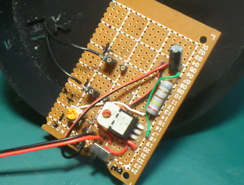

再講, 要由5v drop 1.4v 去 3.6v, 簡單到一粒lm317t  加粒電阻 加粒電容就做到. 我都整個幾件用黎駁led 啦.
手機咁大塊pcb, 要整個drop voltage既circult, 又有幾難呀.
