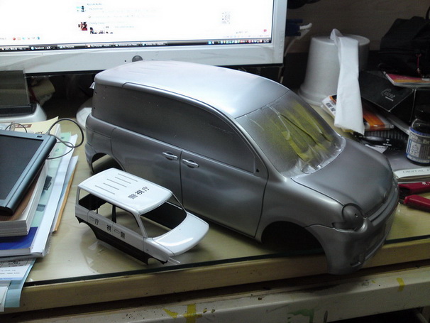

咁大架車,好難噴呀
噴左好多模型,人生第一次噴咁大架車,噴完隻手好似冇反應咁!
俾張相大家睇下大成點
細果架係1/24,大果架我都唔知係咩比例
同埋好似好難噴得平均同平滑,好多毛頭同塵癡左上去,有咩方法搞呢?

look like 1/10?

kobericky 兄玩1:10車????
期望中!!
嘩嘩嘩!!!
唔好講噴到手軟,要拋光都拋到喊!!!
存貨太多,時間太少...

講真,小弟都係第一次見有咁大架呢款車。
十分同意係拋光拋到喊,支拋光膏好快玩完。淨拋光己經用n日…

我都唔知呢架係幾大,但呢架唔係模型,我有個朋友係日本訂返黎送俾人做聖誕禮物,其實係完成品黎既,原本係萍果綠,但車主果架係銀色,所以搵我幫佢轉做銀色車身。
仲要呢個星期起貨,都唔知趕唔趕到,哈哈!

咁大架仲用手拋光? 用 Rotary Tools 哪...

1/10 RC ?       .

RC body useally paint inside and need no polish. And due the plastic material "LEXEN" you have to use special paint like PS color from Tamiya or parma faskolor or else your paint will pill off eventually. If ABS type of body which paint on top, you need to spary metal primer as base. Good luck
