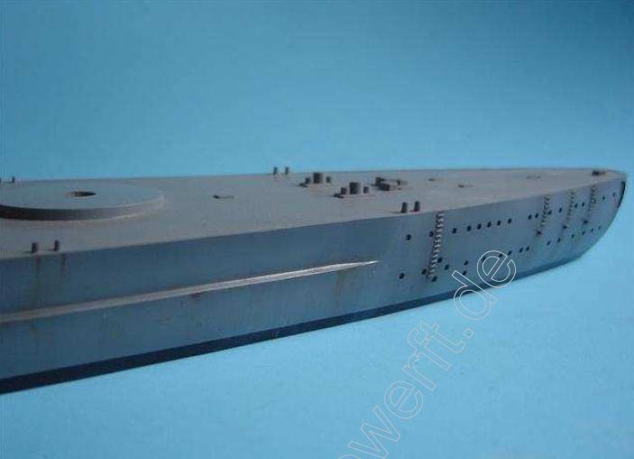

Naval shipyard Tutorial Series No. 1
more annealed steel under use of hair spray
The war, and this is simply his nature, provokes destruction and destruction. A big part of this destruction becomes, for instance, as a result of from explosions, by being roused material, chemicals or by fire means caused. Partly intends, partly uncontrollably, heavy ones often rage for days. Fires, devour person and material and everything is in way what of them. These fires leave beside the proverbial track of the destruction naturally also tracks on the most different Materialen.The tracks of such fires in the model is to be shown the subject of this article.
Moreover we strain once the trunk of a Tamiya 1 / 350th Bismarck class.This trunk was varnished in the example already once and was aged, and is therefore perfectly as a test bearer suitable.
Thetrunk is preshaded, varnished in XF-53 TAM, sealedlightened with white, seals with varnish and with oil paints easily treats.
I intend it is more sensible, the technologies only after a spraying in the same one integrate. It concerns here virtually a kind of detail, in a spraying it is inserted. Maybe it is not to be varnished completely so recommendable only the rust and then the rest all around. But this can decide everybody best of all for itself. Hence, enough of the theory and the chat, on too new actions!
Our first protagonists are an old and strongly shortened bristle brush as well as Gunze's Mr. dissolved Putty.  Of the liquid spatulas is spread with a paintbrush and then during Of drying process with the bristle works on. A rough surface on one originates later can well work.
The model is released at the place to be treated with acetone from the varnish and with "Mr DISSOLVED PUTTY", spotted, treats.
This was real it also already in preparations, because nowif it goes directly in varnish. If we begin with the order of the "purpose color" that is that color, we long to see at the end as a dominating main color decided.
TAM XF-9 "hull red" forms the first, XF-68 TAM "nato brown" the second ones Color order. This time I have myself to one "lighten" from the outside inwards
„ No breathing space, history is done. It leads the way! “ ***, well, maybe now not exactly history, but at the head it goes, nevertheless. And this rather quickly, because we can virtually work „ wet in wet “. Also time-consuming clean to the gun is superfluously. Simply some 2-Propanol (Iso) in the mug, briefly durchspülen and ready. The next color!
Further lightened with Gunze H37 "wood brown"
From here I followed in the arrangement of the colors the principle: „ In the end must go black on top on it and orange below in it. “ This appeared
inevitably around verkokelte and unburned color, in the transitional area to the rest to show to the trunk spraying. There is n.m. E kei no special manufacturers they would be important. Importantly only that is it fine acrylic colors should be. (Gunze or Tamiya, e.g.) this are resistant
compared with the Citrus the turpentine which I use with pleasure for washes. Special ones Verdünner or even "ready mixes" for Washes get on mostly even badly with Enamel or synthetic resin colors.
To the following picture was to me with the thought of the original only one Fakt importantly: Water cools! This cannot signify that the color near the water line completely burns itself down. Thus I have started especially there massively orange. It puts to this orange the rust relaxed in the water which runs about whitely burnt color. Then below the burnt color verkokelte color is only. I do not believe the color in the water in the same way "burns itself down" like in the air.
Orange and knows here two most important colors have been for me.

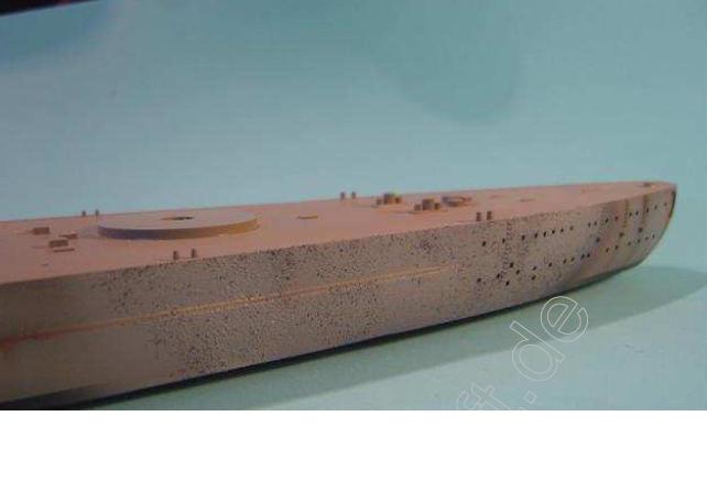

Now at this point became there Now at this point the hair spray was raised.
Simply in an empty stained glass spray and in the gun give. One can do it
perhaps, also directly on the model spray.
Now after an other layer of XF-53 came the edges of the burnt ones
Surface in black and knows.
A way XF-53 TAM. Drying time maybe 10 minutes. This might one
be a variable value. Afterwards once again a little bit black for the edge, similarly
to the preceding picture.
Now real water comes into play. With the bristle brush I applied water and weichte with it the surfaces located on the hair lacquer of the color in. I had to rub a little more hard, besides, and the paintbrush lost some of his bristles. Not possibly because of the intensity, but I shortened him a little bit with it I
more exactly could work. Maybe one can do also without hair spray and just with him Paintbrush and water on it herumschrubben. One bumps under circumstances, as well as in to my case, also sometimes by all colors all colors to down on the plastic. One can do this but easily with the oil paints and some pigment make invisible. On some of her to the following pictures one can in the upper left corner of the brown area
appear, and again see disappearing.
Now the effects step by days. Occasionally I more often have with clear water
rinsed to see in which color layer exactly I was. This
Dishwater complicates in the meantime the view and the precise one work.
Well recognizably the last way black in U form around the fire surface
Now it can go on always nicely carefully. The Putty pointed me
reliably where the undercoated surfaces ended. Further on the next side with
to the pictures after the remove by washing of the color.
With oil paints like umbra and sienna, as well as some pigment, I put even smaller ones Filter and soft-focus lens as well as the last corrections. Voila! The whole action at another place of the same model All protagonists again gathers peacefully.
THATS IT, FOLK! A lot of fun with copy wishes You.
Your Alex ☺

  Thetrunk is preshaded, varnished in XF-53 TAM, sealedlightened with white, seals with varn ...
2009-4-7 03:59 PM
  The model is released at the place to be treated with acetone from the varnish and with " ...
2009-4-7 03:59 PM
2009-4-7 03:59 PM
2009-4-7 03:59 PM
有拖無欠, 總有一天砌得晒

2009-4-7 04:02 PM
2009-4-7 04:02 PM
2009-4-7 04:02 PM
2009-4-7 04:02 PM
有拖無欠, 總有一天砌得晒
