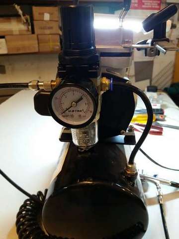

®ð¬¦½ÕÀ£°ÝÃD
¥»¤HªB¤Í©ÒÃØ®ð¬¦¡A·í®É¨S¦³¸ò¤ô¹j¡A²{¶R¤F¦PµP¤lªº¤ô¹j¡A·í»é¦n¸Õ¾÷®É¡AµL½×¦p¦ó½ÕÀ£¡A¤]¤£¯à¼Q¥Xí©w®ðÀ£¡A¤q¨ä¤U½Õ®ðÀ£®É¡A¼Qµ§¼Q¥X®ðÀ£·|¥Ñ§C¹Eº¥Åܰª¡AÂI½Õ³£¤£¯à«O«ù¦P¤@À£¤O¿é¥X¡A¦³®É½Õ§C®ðÀ£¡A®ð¬¦·|¦bÀ£¤O´wº|®ð¡A¤£¯àÀx®ð¡A­n¤W½ÕªðÀ£¤O¤~¤£º|®ð¤Î¨¦®ð¦Ü®ð¬ûª½¦ÜÀxº¡¤~CUT¾÷¡A´±°Ý¦³µL®v¥S¹J¨ì¬Û¦P±¡ªp?  À³¦p¦ó¸Ñ¨M¡C

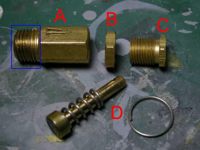

ª½±µtune¤º¸m®ð¹j·íµM¤£¦¨°Õ.
¦ý¦³¨Ç¥s"­·¤O©ñ®ð»Ö"(¤ôÀsÀY)ªºªF¦è¥i¯àÀ°¨ì§A.¤W²^²^§ä§ä.¤£¬O«Ü¶Q.
http s://world.taobao.com/item/528583320611.htm?fromSite=main&spm=a21f2.7918495.1000002.7.jgu7DO
¤@¨ÇÁÙ¦³®ðÀ£­p
http   s://world.taobao.com/item/41570978243.htm?spm=a312a.7728556.201601086188259.6.4hwlpf&scm=1007.12679.20634.41570978243

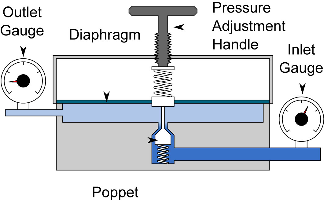

"­þ­Ó"À£¤O´w"¥\¯à´N¬O¹LÀ£±Æ®ð.¤£¬O¹h®ð." ²b«Y©O¥y, ´Nª¾§A»{ÃÑd °t¥ó¬Jª¾Ãѧ¹¥þ¦³­­, ¥ò«Y¿ù»~²K.
©OºØ pressure regulator ½ÕÀ£¨î. . ³]­p«YËÝ.
«Y±q¨ÓÉN¶·­n"©ñ®ð"¥h±Æ/´îÀ£¬J.
