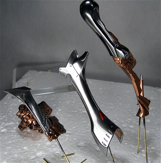

很閃亮的銀色 ! 如何制作?
請問有無師兄知道相中既銀色係點做出黎架 ?
好閃,好光滑.

表面處理超滑
上灰上黑底, 上一層就拋一層, 唔拋都用2000up的砂紙處理下
黑底再上厚光油,又再拋
用又靚又閃又幼的銀油
上左又再上一層光油
又再拋, 冇塵呢下唔使多講啦

原帖由 VampireA 於 2010-9-14 11:25 AM 發表
個blog 有講喎...
http://blog.livedoor.jp/noblesse_/archives/cat_60242900.html
要整到鏡黑再噴呢隻銀>
http://www.spazstix.jp/index.php ... amp;products_id=264
想問師兄隻油香港有無得賣

發表於 2010-9-14 12:08 PM  資料  短消息  加為好友
美國同日本都有, 香港未見過... 本身係美國野...  而且都幾很貴..  2oz 要usd 12.49, 仲要係唔好再開稀.... 另外最好係50%濕度以下噴...
http://www.spazstix.com/xcart/10 ... SH-PAINT-2-oz..html
http://www.spazstix.com/index.php
Question: Where can I find Mirror Chrome Airbrush instructions?
Answer: "Mirror" Chrome Airbrush Directions Panel. 1) Use Surface Pre-Prep prior to painting to remove any dirt and oils such as fingerprints. 2) Let bottle warm to room temperature (70 degrees farenheight) 3) Under 50% humidity offers best results. 4) Cover surrounding items to protect from overspray. 5) Shake until the ball inside bottle breaks loose. Continue to shake for one minute. 6) After each minute of spraying, REPEAT shaking procedures for ten seconds. 7) Spray 4" to 6" from surface at 15-20 psi. 8) Test spray for distance prior to painting. If too far away, coverage could be uneven. 9) Spray in thin, even coats instead of one heavy coat. 10) Apply 3 to 5 thin coats. You can tell when it is ready to be back by holding a dark black or blue cloth behind it. 11) Back with Waterbased paint only. 12) Recommend backing with Black for best effects. 13) Clean airbrush immediately with a high quality lacquer thinner.
個blog 有講喎...
要整到鏡黑再噴呢隻銀>
真是很棒的銀色, 不知將來會不會有家庭式電鍍機

發表於 2010-9-14 04:21 PM  資料  短消息  加為好友
原帖由 一休 於 2010-9-14 12:22 PM 發表
日本十幾廿年前出過, 當年hobby japan 有介紹, 當年勁貴, 仲要d藥水maker 唔知可唔以refill..
