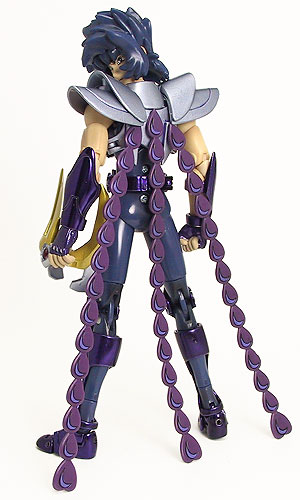

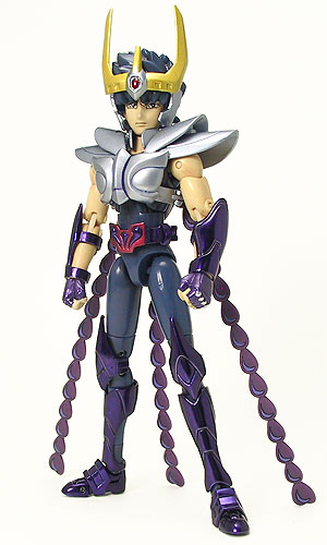

磨沙效果問題:想問問各位師兄點樣可以做到下圖胸甲的磨沙效果
如果我用開希的牙膏不地簿塗得唔得

唔算磨砂
噴完銀色噴消光就得

我反而覺得係噴完消光先噴銀色
噴完銀色噴消光會令整個色澤變沉
噴完消光令表面粗糙應該就會ok

要做到官圖唔需要咁令
其實可以噴粗surfacer

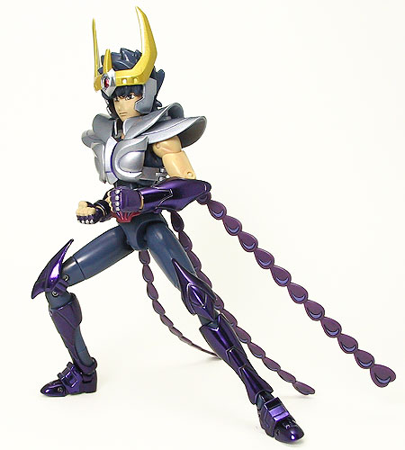

其實我係想做到好似d金器(下圖)的啞色咁

金屬油可唔可以溝消光 再噴

其實唔洗咁煩, 噴粗d, 底油亦唔好咁滑就會出磨沙樣,
問題係, 點控制粗幼砂既效果..

may be use a rough sandpaper + layers of 500 primer
or just 500 primer
not too smooth nor too rough

I have used a similar silver; Tamiya X-32 Titanium Silver
Or Tamiya X-31 Titanium Gold X-31
Not sure about Mr.Color
I found a sample online:
http://www.axelv.com/307wrcpirelli-br02.html
