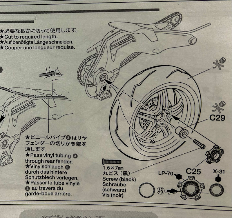

小弟正在砌緊 Ducati super leggera V4,去到步驟10上後轆時,發覺螺絲永遠都扭不緊,上網見人哋都係用黑色螺絲,唔知各位師兄有冇遇過?

螺絲扭不緊? i assembled several tamiya bike, even its previous version, doesn't have this problem.
black screw has three size in kit:
1.2 x 4mm
1.2 x 6mm
1.6 x 7mm (this one for rear wheel)
you sure you use the right one?

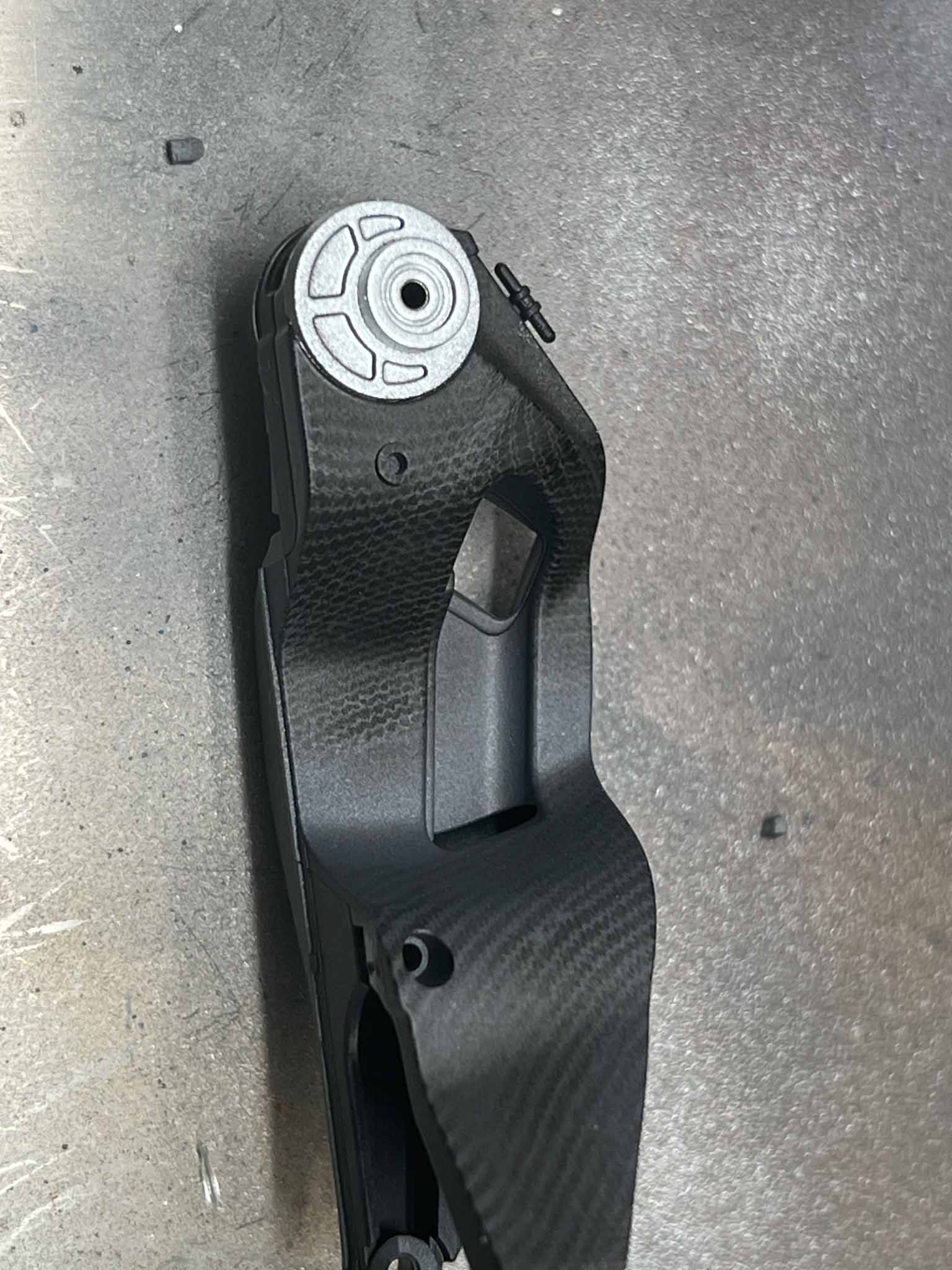

其實我也組裝過幾架電單車,但就是這個唔知點解個窿咁大,我嘗試放螺絲入呢個窿都直接跌到落底,即係話個窿口太闊,但係黑螺絲又得返一口,我都是第一次遇到這個問題

check step.8,
there has rubber cap inside rear wheel support frame,
and you are screw the black screw into "C29", not the hole.
just same as previous version.
should not occur "直接跌到落底"...

多謝各位師兄幫忙,已解決,原來我將Step6 C20個口螺絲掉轉咗,好在冇擰爆
